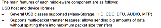

how to transmit data buffer without splitting? Im using HAL library and it says its allowed to send multi-packet without splitting, but when i try to send data to PC it splitts into max packet size that is 64 byte size

Max packet size for FS is 64 bytes. HAL can send a buffer larger than 64 bytes in one command, but it does so by breaking them up. I don't think it's claiming otherwise.

screenshot from HAL lib user manual (UM1730)
