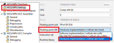

In your project settings in CubeIDE, go to Floating-point ABI:
"Hardware implementation .." needs to be selected.
Normally the RTOS is taking into account the FPU registers handling.
Hope that helps
Hope that helps
