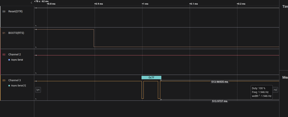

When we flash the FW to STM32F405RGT6 via FT232RL, it fails to enter bootloader mode sometimes. Failling rate is around 40-50%. I observed signal behaviour about Reset(DTR) and BOOT0(RTS) with logic analyzer. In success case, its behaivor looks fine but we saw the steep voltage drop on Reset(DTR) in fail case. I tried putting pull-up resistor(10K) on DTR line but it didn't work. Actually, I have no idea about that voltage drop and what is going on the STM32. Is it not hadware related issue?

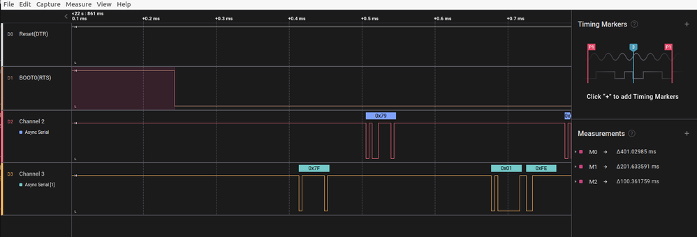

I captured the datalink packet and found that FT232RL sends 0x7F and STM32 reply 0x79 in success case but FT232RL sends 0x7F and STM32 doesn"t reply anything in fail case.
So, is this a issue on STM32F405 side?

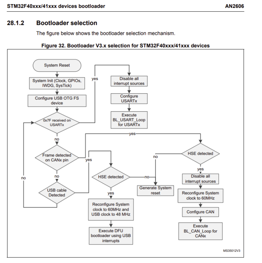

I'm using PB5/6 for CAN interface and Battery(Toshiba:FP01101MCB01A) is connected to it.
Actually, when failing to enter bootloader via USART, STM32 detected some frame on CAN and went to CAN bootloader process. (refer to the flowchart on attachment file).
As a experiment, I removed the battery from CAN interface and trid to enter bootloader and wrote FW.
Fail rate was 0 out of 20 times. I guess CAN communication happend during bootloader entering process and when STM32 could not catch 0x07F, STM32 go to CAN frame detection process and detected CAN fram and not come back in failure case.
Do we have any workaround to do this without changing the current electrical schema?

Now the picture becomes clearer. If your battery is connected to CAN2 where the bootloader expects a host and you don't want to use your own bootloader, you will have no other choice but to redirect these connections to PB12/13.
Since the built-in bootloader cannot be changed, it should always make sense during project planning to check the interfaces mentioned in AN2606 carefully to see whether devices connected to them can interfere with the bootloader process.
