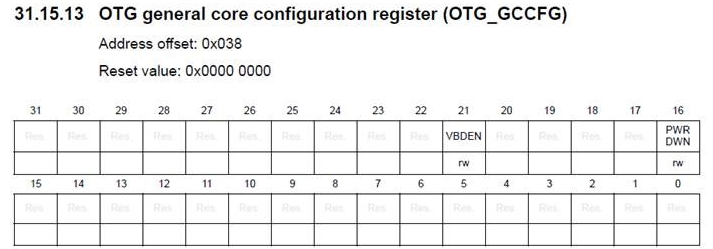

I tried to debug, but it seems there are some mistakes in the library and the datasheet.
1. Page 1140 of the Reference Manual of STM32F446, the register 'OTG_GCCFG' does not comply with the USB_OTG_GCCFG_TypeDef structure defined in usb_regs.h
2. In USB_OTG_GCCFG_TypeDef structure, the 'disablevbussensing' should be 'enablevbussensing' regarding the definition of register
OTG_GCCFG / bit 'VBDEN' => consequently, there are some mistakes in the library (setting 1 instead of 0 to 'disablevbussensing' variable)
3. In the Reference Manual, page 1100, it talks about the SOFOUTEN bit of OTG_GCCFG register, bit this bit is not defined regarding page 1140
However, if I try to 'fix' the possible msitakes, I don't manage to disable VBUS sensing feature.

You didn't answer about a problem in the datasheet itself (not related to the library) :
What I need to do is to disable VBUS sensing because my PA9 pin is used for another purpose (USART).
But now that I know the library is incorrect, I'm still not sure if the datasheet is correct or not.
Based on what is written in the datasheet, I couldn't manage to disable VBUS sensing.

2017-06-01 9:58 AM
Khouloud,
The related reference manual will be updated. The SOFOUTEN bit shouldn't have been mentioned.
I am now completely confused.
Does that mean that SOF is not available on PA8 for OTG_FS and PA4 on OTG_HS?
And that they both are not available as optional input to TIM2_ITR1 ?
Or does this mean that SOF is available out from OTG_FS/OTG_HS at all times, regardless of how OTG_GCCFG bit 20 is set; and it is gated only at the GPIO/TIM2 level?
