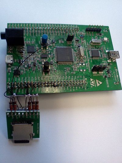

My current GNU release for the STM32F4-Discovery USB MSC for an external SD Card is attached to this post.
/public/STe2ecommunities/mcu/Lists/STM32Discovery/Attachments/2816/stm32f4_discovery_msc_sdhc_release_3.zip
