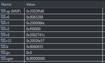

Now I want to do the same thing with my actual project, but it ends up in a hard fault everytime. The Fault Analyzer says "Attempt to switch to invalid state" after I execute the jump command.
Register content during fault exception:

2021-07-22 2:26 AM
In the register list, PC is zero, so you probably read zero when SysMemBootJump = (void (*)(void)) (*((uint32_t *)(address + 4)));
Single-step that code in disasm view (instruction-step) while observing the registers' content.
2021-07-22 2:53 AM
pc gets set to zero after SysMemBootJump();
directly after SysMemBootJump():
