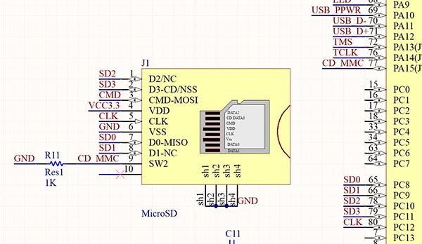

I am Using STM32F207VC And Micro SD Card With SDIO Interface And Fatfs Library When I Debug And Trace Code, SDIO Routine Response This Error: /*!< Card is not V2.0 complient or card does not support the set voltage range */ What Is Mean? What Do I Do For debug This Error? #fatfs #sdio #sdio #stm32f207 #dma-config-for-sdio2016-07-11 5:09 AM
Describe the specific card (make, model, capacity, etc) you are having problems with. Are other cards working? Is the interface wired correctly? What board is this?
Make sure the SDSTATUS_Tab has 64 elements. The error seems to suggest the card is non-responsive Test the code/card on known working hardware.2016-07-11 5:53 AM
hi clive And Tanks For Response
I Read AArticle
?About SDIO Interfacehttp://blog.frankvh.com/2011/09/04/stm32f2xx-sdio-sd-card-interface/
That Write About Hardware That must Use A Buffer For SDIO Voltage My Board Dont Have Any Buffer And Connect MicroSD Driectly To STM32F207VC Is There Any Issuse For This Problem?2016-07-11 12:47 PM
