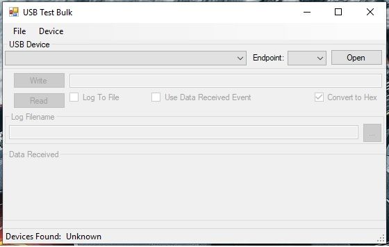

I use "Test Bulk" software on PC for libUsbWin32 to test endpoint work. It can be transmit or receive data with EP1_IN,EP1_OUT, EP2_IN,EP2_OUT, EP3_IN,EP3_OUT but with EP4_IN, EP4_OUT it can't. 0690X000006DlaGQAS.jpg
