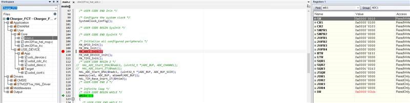

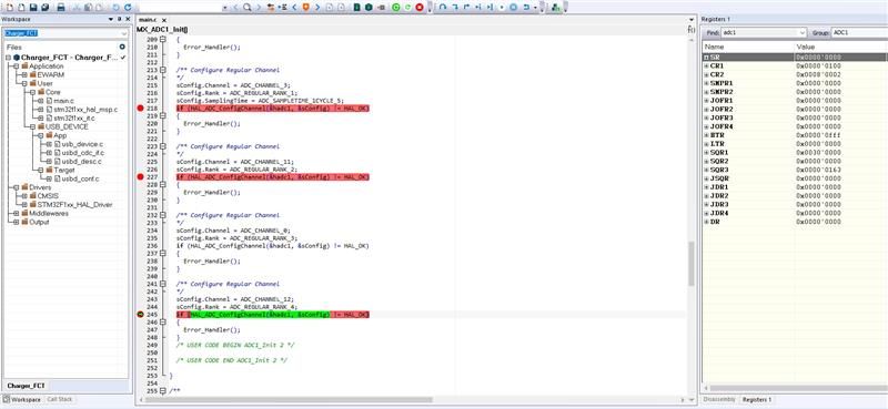

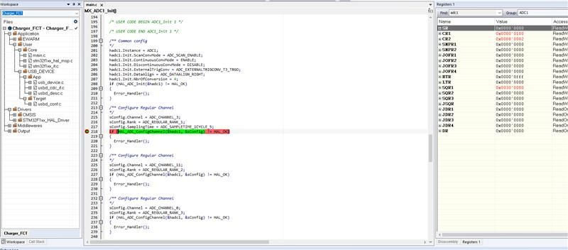

Hii team i am working with STM32F103RET6 mcu and i want to read the ADC value in DMA mode of multi channel and send these value to the PC using USB. but i am getting stuck in MX_ADC1_Init().
if (HAL_ADC_ConfigChannel(&hadc1, &sConfig) != HAL_OK)
Error_Handler();
} here my code is going to Error Handler and also i am getting proper value from ADC. i am
attaching my Zip file please review it and modify accordingly. i am newer to Stm32 so not getting any proper
solution for this.
