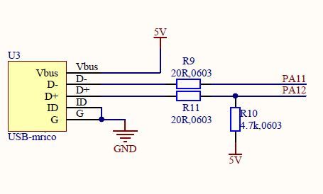

I am trying to make usb hid connection with STM32F103C8. I was able to compile the USB Library via the KEIL Compiler. The processor is running. After the USB init routines, the processor goes to the main program. And when I make the USB connection, I get the error that the ''USB Unknown Device''
USB connection as shown
My project file is attached. Can someone review the project?
What causes this problem?

Dear gentleman,
You should check the DP/PA12 ( D+) Pull -up management. It should be 1.5Kohm and pulled to VDD ( 3Volts to 3.6Volts) and controlled by a GPIO to soft connect and disconnect it.. in software it is not inline using our default Eval bord configuration PC9 pin.

As you said, I tried with 1K5 and 3.3V pull up. But this way the computer does not react at all. The device is not detected by the computer at all
Now I'm testing it with a 10K resistor and a 3.3V pull-up. When I try with a 10K resistor on the circuit diagram, sometimes it works fine. Especially if you do nothing in the main program, the usb connection is provided properly. However, the USB connection fails if you use an external hardware such as activate Timer interrupt etc.
I do not understand what the problem is. What do you have to do with external equipment?

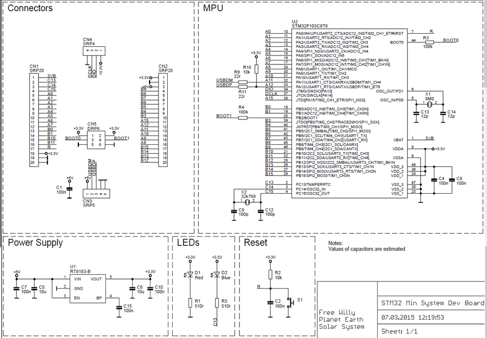

On this moment I'm using a Blue Pill board that have also a
STM32F103, the only difference is that the PA12 is connected to 3.3V through a 10K resistor as you can see in the image below:
I decided to ''port'' the example that is provided with the HAL using the CubeMX initialization to this board and works well, in the example the microcontrollers worksas an USB-to-serial converter, if you just power your micro with 3.3V the LED don't blink, but if you power the board through the usb port, the PC recognize the virtual serial port and the LED blinks. I attach the code to this post if want to check ita and in the folder is also de .ioc file of the CubeMX if you want to port it to Keil.

Hi!
10k pullup usb, 100pf!! caps for LSE crystal, super bright (510Ohm) Leds , no VDDA 'some kind of isolation'. At least is cheap.!!

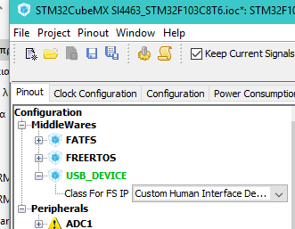

Now I have created a project with CubeMX for the USB hid example. When I run this project on the STM32F103, the computer recognizes my device as a USB Mouse. But I want to use it as a Custom HID device. How are the settings related to this? How do I fix my descriptor file?
