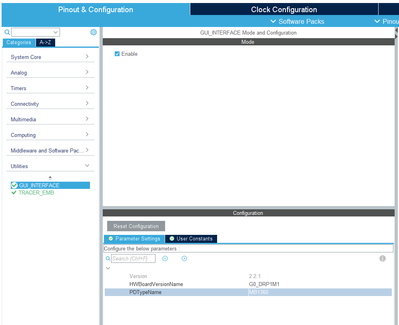

Hi Nicolas,
Here are my settings for 2.9.3 of the guide:
Nate
