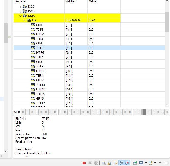

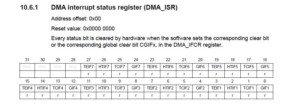

Project for STM32G071 (Nucleo), Bit names in SFRs wiev for DMA->ISR has wrong numbering.

Just to update you that the needed fix is done on G071 and will to be replaced in upcoming version for STM32CubeIDE with correct SVD file.
regards,
