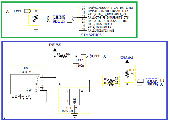

See the schematic of my board. I'm not using U_DET pin.

Stm32Cube generated project for IAR works, pls find attachment. This means Hardware is fine.
But I still wonder why my code is not working ! see the usbd_cdc_interface.c and .h files for what I have modified from sample. CDC_Itf_Init() and CDC_Itf_Control()functions must be called, but are not being called. This could be problem. ________________ Attachments : CubeMXproj.zip : https://st--c.eu10.content.force.com/sfc/dist/version/download/?oid=00Db0000000YtG6&ids=0680X000006HzRw&d=%2Fa%2F0X0000000bM4%2F.Coa1hMxMYJk_UvVI5TIojS_WK1MbsWB5w10KeMvUmI&asPdf=falseusbd_cdc_interface.c : https://st--c.eu10.content.force.com/sfc/dist/version/download/?oid=00Db0000000YtG6&ids=0680X000006HzRm&d=%2Fa%2F0X0000000bM3%2FqIAfvbeNRXpvVMBL7kPl1NZ3QcMBqXoQenroN9w0Tgs&asPdf=falseusbd_cdc_interface.h : https://st--c.eu10.content.force.com/sfc/dist/version/download/?oid=00Db0000000YtG6&ids=0680X000006HzM5&d=%2Fa%2F0X0000000bM2%2FR41D4OIr1b_ytLEZiQSEQXpQbvOpAuQ2UNaYgLrWZtA&asPdf=false2014-04-17 1:36 AM
It is working. The problem was with VBUS pin initialization and sensing settings.
I removed VBUS pin initialization in usbd_conf.c in the following functionvoid HAL_PCD_MspInit(PCD_HandleTypeDef *hpcd)also disabled sensing in USBD_StatusTypeDef USBD_LL_Init (USBD_HandleTypeDef *pdev)hpcd.Init.vbus_sensing_enable = 0; It means, I'm not using VBUS now.Thanks for all the help.2014-04-22 3:11 AM

@STM32Cube-T
The problem i described was not in the CubeMX project. It was in the CDC_Standalone sample in STM32CubeF4 firmware package. Also, the hardware is designed in our lab.We’re moving the ST Community to a new platform to give you a better and more reliable community experience.
