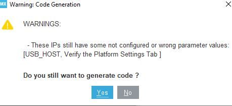

Hi @ABhat.7 ,
Sorry for the delay to answer you, as I'm working from home and I haven't the STM32F107 board at home.
But, after checking your ioc file, there are some warnings to configure USB parameters in the Platform Settings Tab.
When running your project, I get several errors and warnings.
I recommend you to use the CubeF1 version V1.8.1 or upper (as contains USB update and enhancements) and refer to the USB MSC example with STM32CubeF1 MCU package:
STM32Cube_FW_F1_V1.x.x\Projects\STM3210C_EVAL\Applications\USB_Host\MSC_Standalone
You can use the example code provided and compare the code/functions with yours.
Imen

Hi,@Imen DAHMEN thank for reply first the pics you share is cause warning since i am not using any gpio for the vbus i simply put a resistor divider across the vbus pin and activate it so cubemx is showing error and right now i am using library version v1.8.1 and last i have a custom board with stm32f107 controller so i put just simply compile and debig the code in to the controller but it is causing the hard fault which i notes during debugging so please tell me what i am doing wrong is it necessary to take a gpio for activating vbus and also i note that when we are generating code with cubemx it not defining Dp and Dm as gpio please help me in this

Hi, @Imen DAHMEN as per your advise i revised my project with latest stm32cubef1 library v1.8.3 so i am attached my latest .ioc file and the warning is coming since i have not selected any option for vbus activation since my idea is to always keep vbus on i.e i simply put a resistor divider that has 4k7 and 10k resistance so that i can get supply as per mentioned in hal usb host document i simply donot want to use any gpio apart from that all configuration is done as per ST usb training video ,kindly advise me what is wrong i am doing that my device is not getting detected while debug i always notice my appli state as application start.
