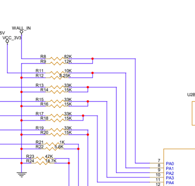

- So, the circuit is like below:
If I increase WALL_IN voltage (connected to analog channel 0) to a value say 12V or decrease the value to 8V, the VCC_3V3 (connected to the analog channel 1) should not be affected. But in my case, it is increasing to 3.2V or decreasing to 2.8V corresponding to the WALL_IN voltage change. I checked in the hardware at pin 8, it remains 3.3V irrespective of WALL_IN voltage levels, but in software, it is mirroring the WALL_IN voltage (raw adc value is same for both channel 0 and channel 1).

The ADC is not designed for high impedance signal sources. Read the following application note: AN2834
What can help is capacitors on the outputs the voltage dividers to buffer the signal voltage while the sampling capacitor is charged. And increase the sampling time significantly. If it fully charges each time the individual measurements are more accurate and cross talk should be lower too.
