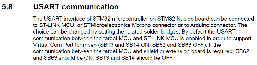

The The STM32 Nucleo boards integrate the ST-LINK/V2.1 interfacing with the PC and offering the following capabilities: – Debug and programming port – Virtual com port interface – Mass storage interfaceTo have insight into the use of the STM32 Nucleo boards Virtual Com port feature, you can refer to the following example, under thehttp://www.st.com/web/en/catalog/tools/PF259243#
:Firmware\Projects\STM32F401RE-Nucleo\Examples\UART\UART_PrintfRegards.

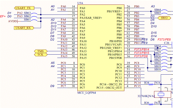

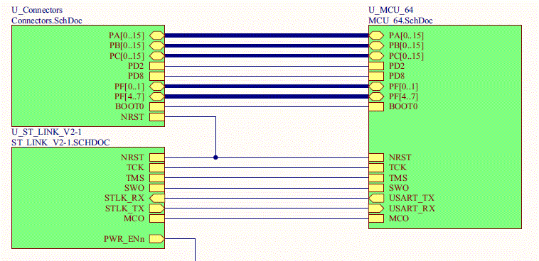

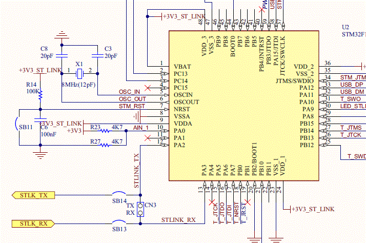

Sorry, but I don't get it. The example just shows the USART being configured and printf is used. On my nucleo the USART on PA2 and PA3 is connected with the ST link. Does this mean, I can use USB / virtual COM with this USART pins?2014-09-17 8:22 AM
The ST-LINK facilitates it's VCP via the USART pins attached to it.
[DEAD LINK /public/STe2ecommunities/mcu/Lists/STM32Discovery/Flat.aspx?RootFolder=/public/STe2ecommunities/mcu/Lists/STM32Discovery/USART%20example%20code%20for%20Nucleo%20F401RE&FolderCTID=0x01200200770978C69A1141439FE559EB459D75800084C20D8867EAD444A5987D47BE638E0F¤tviews=311]https://my.st.com/public/STe2ecommunities/mcu/Lists/STM32Discovery/Flat.aspx?RootFolder=%2Fpublic%2FSTe2ecommunities%2Fmcu%2FLists%2FSTM32Discovery%2FUSART%20example%20code%20for%20Nucleo%20F401RE&FolderCTID=0x01200200770978C69A1141439FE559EB459D75800084C20D8867EAD444A5987D47BE638E0F¤tviews=3112014-09-17 8:34 AM
