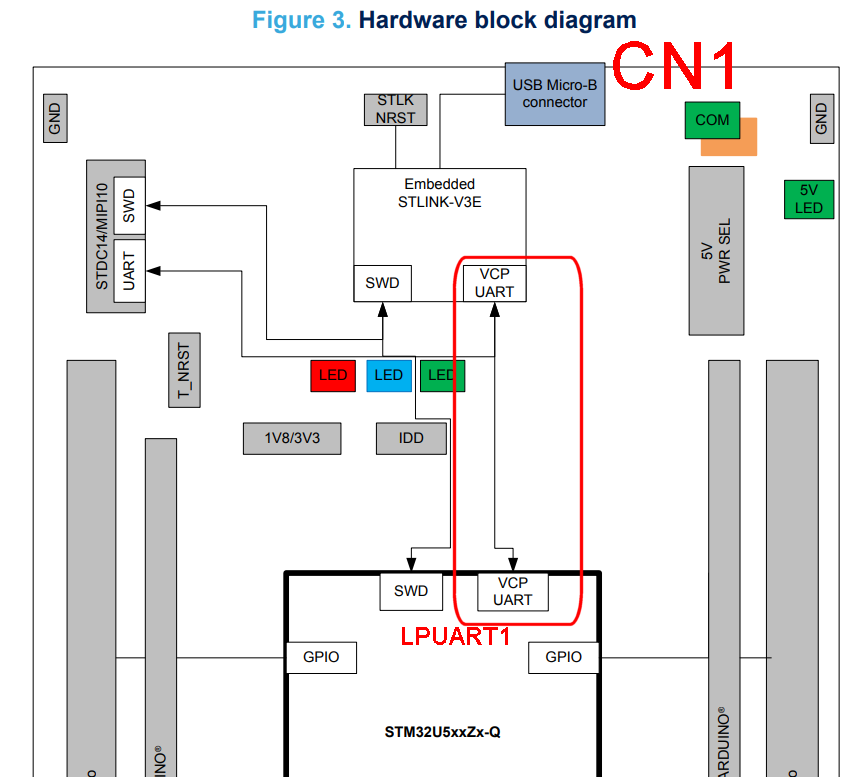

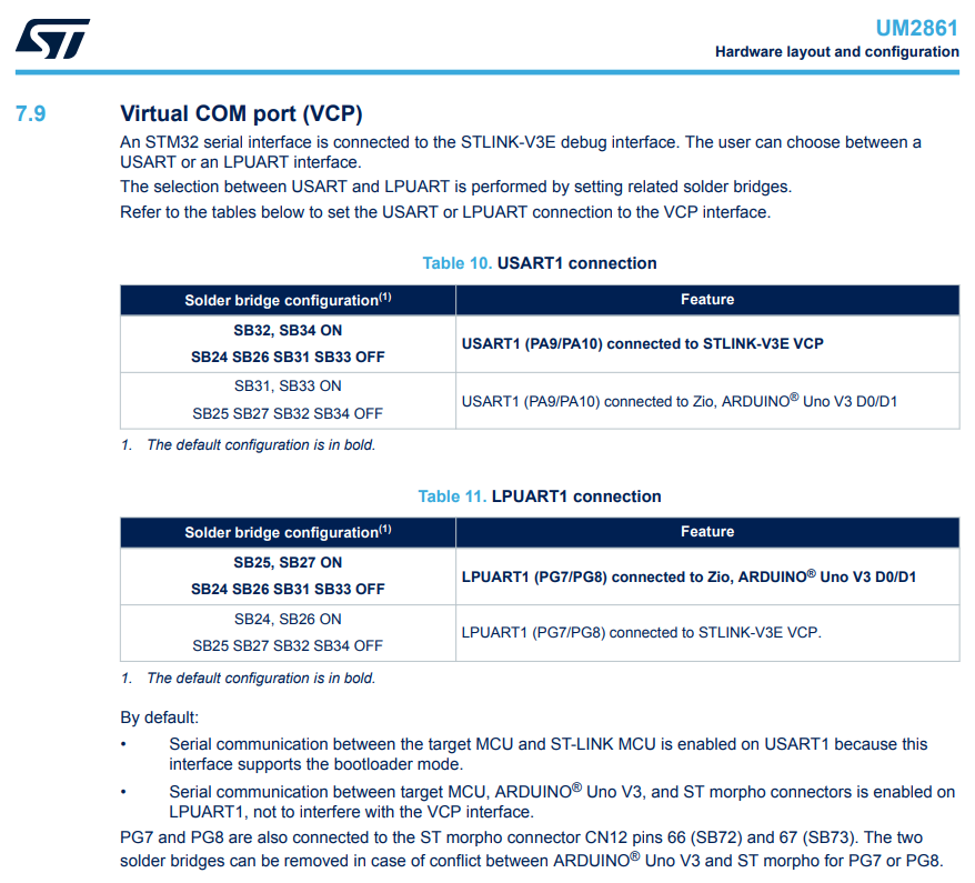

More specifically, via the Virtual COM Port (VCP) provided in the ST-Link on your Nucleo U575ZI board?
As you can see in the User Manual for the board, the ST-Link's VCP connects to a UART on the STM32U5 Target chip:
This give you a UART connection to the Host PC via the ST-Link's USB connection (Micro USB; CN1) without the need for any USB code in the STM32U5 Target chip.
This Virtual COM Port is, by default, connected to LPUART1 on PA9,10:

To create a "virtual" UART link over USB, you would not use a real UART on the Target microcontroller at all - the comms would be purely through the USB software.
As noted above, by far the simplest way to get UART comms with a PC is to use the ST-Link's VCP.
