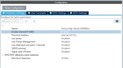

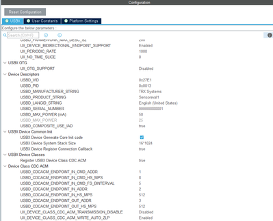

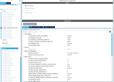

2024-09-03 11:21 AM
Hi @FBL,
My use case is a CDC ACM device in standalone mode. I am running baremetal with no RTOS.
In ux_device_cdc_acm.c, I register write and read callbacks using ux_device_class_cdc_acm_ioctl with UX_SLAVE_CLASS_CDC_ACM_IOCTL_TRANSMISSION_START. The device enumerates on the host PC and I am able to connect to it. When I send data from host PC, the read callback that I registered previously gets called and the firmware receives the expected data from the host PC.
My problem is when writing from my device to the host PC. I'm attempting to use ux_device_class_cdc_acm_write_with_callback() to write data to the host PC. The function returns UX_SUCCESS, but my host PC never receives the data. In my main loop, I call ux_device_stack_tasks_run(), which eventually calls _ux_dcd_stm32_transfer_run(), seen below.
Line 6 never evaluates to true and this function always returns UX_STATE_WAIT.
// ux_dcd_stm32_transfer_run.c
/* ED transfer in progress. */
if (ed_status & UX_DCD_STM32_ED_STATUS_TRANSFER)
if (ed_status & UX_DCD_STM32_ED_STATUS_DONE)
/* Keep used, stall and task pending bits. */
ed -> ux_dcd_stm32_ed_status &= (UX_DCD_STM32_ED_STATUS_USED |
UX_DCD_STM32_ED_STATUS_STALLED |
UX_DCD_STM32_ED_STATUS_TASK_PENDING);
UX_RESTORE
return(UX_STATE_NEXT);
UX_RESTORE
return(UX_STATE_WAIT);
Below are my STM32CubeMX configurations for the USB peripheral and the USBX middleware.
Any input is greatly appreciated. Please let me know if you need anything else from me.
