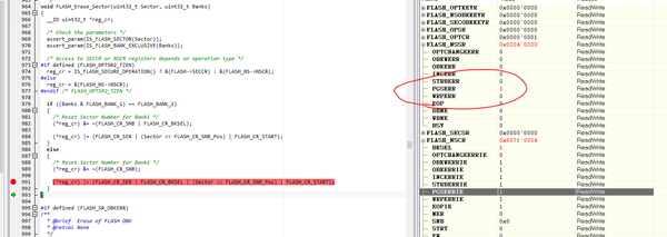

and I debug HAL_FLASHEx_Erase_IT() --> FLASH_Erase_Sector(), find after executing line991, it cause a PGSERR interrupt, which means programming sequence error. But it also not causes an interrupt, I do not know why?
