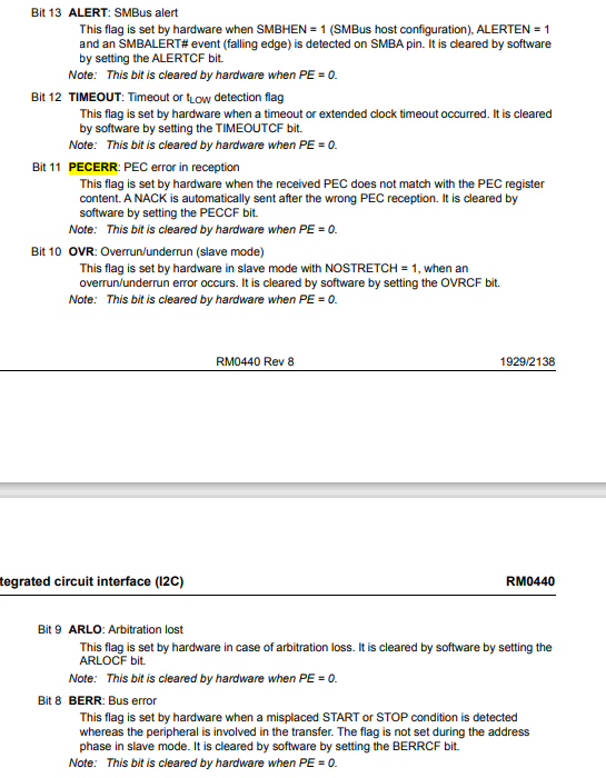

Hello @photon
These flags "I2C_FLAG_PECERR, I2C_FLAG_TIMEOUT, and I2C_FLAG_ALERT" cannot be cleared by software. They are cleared by hardware when disabling the peripheral.
