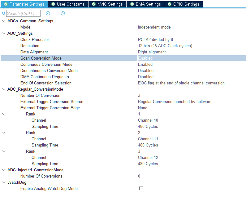

Here is my configuration for ADC, interrupt is enabled, DMA is not used.

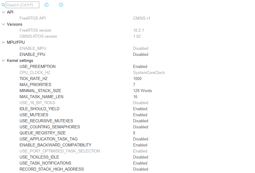

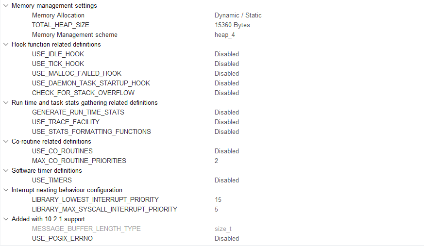

Here is my RTOS initialization:
