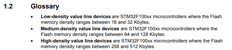

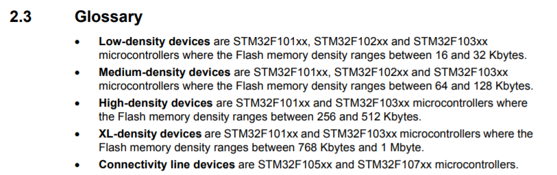

Hi @Senax ,
In the Glossary of RM0008, you find the following explanation:
A complementary explanation for value line (vl) in RM0041:
STM32F103RB is a medium density device (128Kb flash), so you will have to select startup_stm32f10x_md.s.
