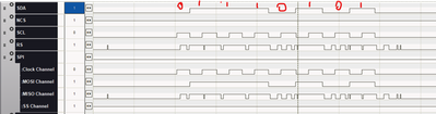

I am experiencing significant noise, making it difficult to read data on the SDA line. While executing the write command, the CS pin goes low.
To identify the data value, I toggled the CS pin during data transfer.
When I sent 0x75, I received the same value in the waveform.
thanks
Mathan
2024-08-13 7:09 AM
Why is RS toggling? Perhaps it's floating, or perhaps it's not connected to what you think it is. In any case, it shouldn't be toggling.
I don't see edges on NCS around your command. NCS should be low before the command and high after. Zoom out enough to see them and ensure they're valid.

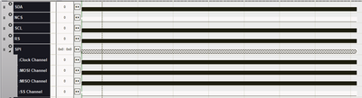

2024-08-13 7:24 AM
Full view of CS pin & without RS toggle
2024-08-13 8:08 AM
RS is still toggling. CS is not low during the transaction. Those are both issues. Or am I missing something here?

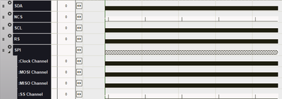

2024-08-22 1:17 AM
Here I attached the waveform after fixing the RS toggle issue. still, the LCD is not working.
ST7735_WriteCommand(0x75);
ST7735_WriteData(&dummy, sizeof(dummy));
ST7735_WriteCommand(0x97);waveform for the above code
Thanks

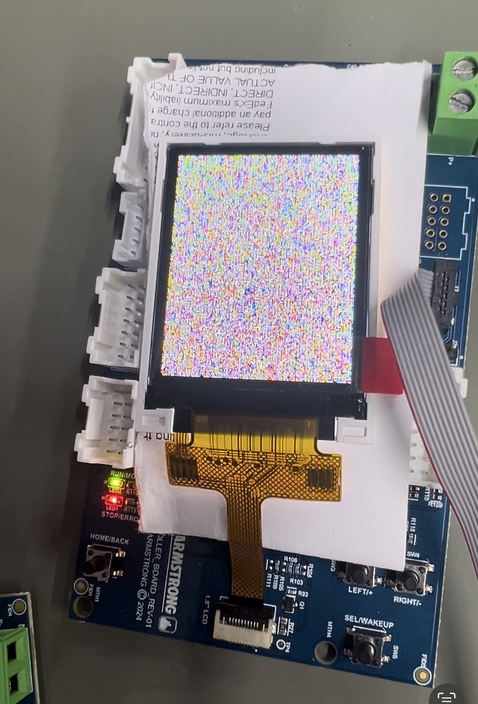

2024-08-22 4:40 AM
ST7735_Init(0);
fillScreen(BLACK);
testAll()
while running testAll(). I got below image
Thanks
