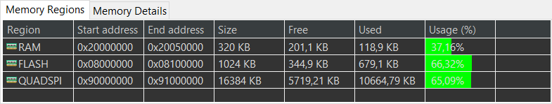

Here is the memory used :
I am using an USB flash drive to update my system program. I know I need to split .BIN file into multiple files which can describe multiple regions. I can use FromELF to do this but I don't know how to use it...

I used this command : arm-none-eabi-objcopy.exe -O binary --only-section=ExtFlashSection "${BuildArtifactFileBaseName}.elf" ExtFlash.bin;arm-none-eabi-objcopy.exe -O binary --remove-section=ExtFlashSection "${BuildArtifactFileBaseName}.elf" STM32F746.bin
Size of file "ExtFlash.bin" : 10.3 Mo (good)
Size of file "STM32F746.bin" : 2.13 Go (not good)
I want only the FLASH section...

I don't know if this will fix your issue, but I was able to separate the internal and external successfully without a 2GB large internal file. It was using a command similar to @MMerc.1 .At least with my project, I had an additional section in my external flash "FontFlashSection", so that section needed to be removed from the internal flash file and added to the external flash section. If I neglect to do this, I get the 2GB size internal flash size bin file.
arm-none-eabi-objcopy.exe -O binary --only-section=ExtFlashSection --only-section=FontFlashSection "${BuildArtifactFileBaseName}.elf" ExternalFlash.bin;arm-none-eabi-objcopy.exe -O binary --remove-section=ExtFlashSection --remove-section=FontFlashSection "${BuildArtifactFileBaseName}.elf" InternalFlash.bin
