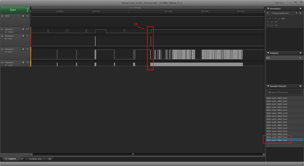

I try to communicate with an external SPI-Flash IC. The SPI uses software NSS. The communication is good but only if I'm not using DMA.
When I try to communicate with flash using HAL_SPI_TransmitReceive_DMA() function and try to transmit or receive more than 2 bytes, the communication fails. Because of on second transmitted byte NSS goes into High (unactive) mode.
I also try to use TxRx transmit complete callback, but the behavior is the same.
What I do wrong? How to force NSS pin rise up when the transaction is complete?

The DMA system doesn't know anything about your software control of NSS. It will not call your code.
If you were to assert NSS, then start the DMA, then deassert NSS, assume that the DMA start takes no time. At that point it is all in the hands of the hardware.
You can see in your plot that SCK starts before NSS gets deasserted. This is the start of the DMA hardware doing the transfers, but control is given back to your code and you deassert NSS.
Assume that HAL_SPI_TransmitReceive_DMA is asynchronous. You shouldn't deassert until you get the DMA complete interrupt.
