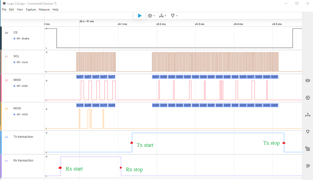

Here is an example of a successful transaction
The CS signal drops to logic zero. Then the slave receives an instruction on what to do - read or write - and in the second part of the transaction performs this instruction. After the exchange of information, the CS signal returns to its original state.
The figure shows an example when a slave device receives a request to read 16 bytes of data from it.

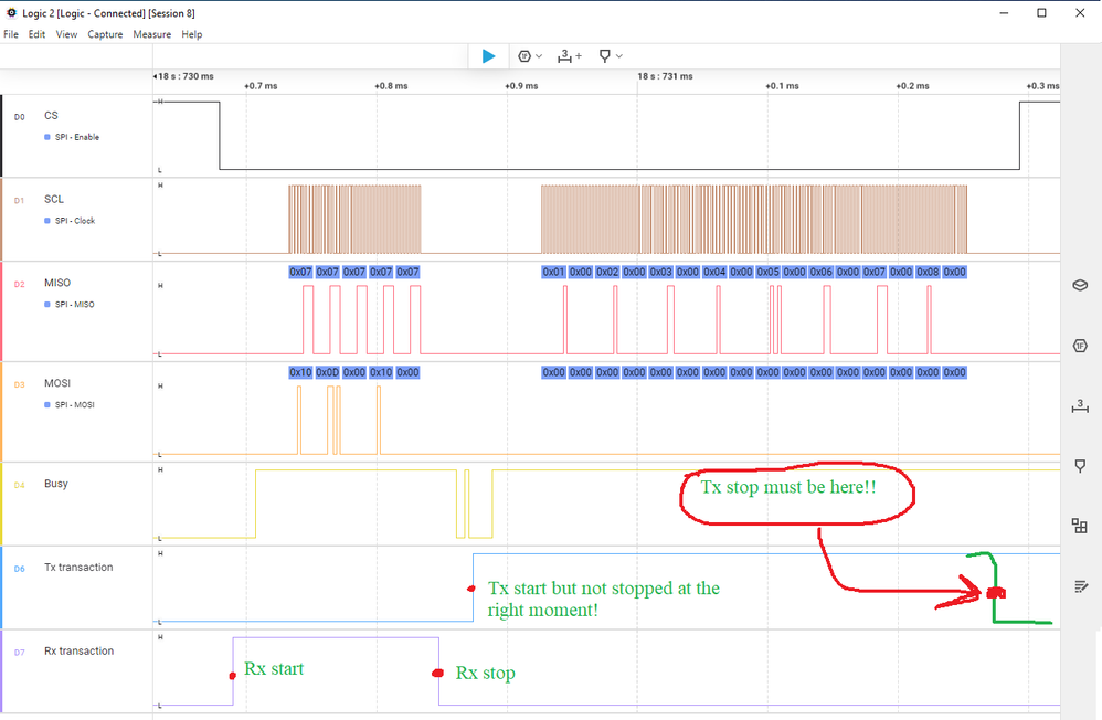

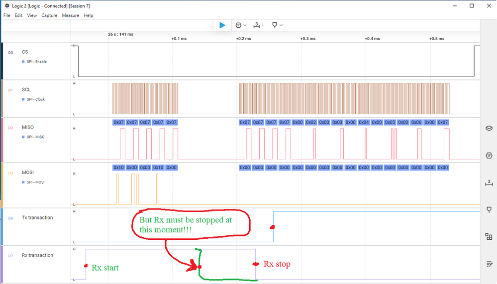

Problem: sometimes the slave device loses data. It can process several hundred transactions correctly, but then a situation happens that it waits for 5 bytes as usually, these 5 bytes actually arrive because I see them with a logical analyzer, but the slave as if at the last byte, stops receiving and gets into an interrupt and stays there all the time until the next packet data (which occurs after some time) from the master.
It looks like this:
A similar situation can happen in the second part of a transaction. It looks like this:

Could you please clarify what the signals Tx transaction and Rx transaction represent?
2024-05-31 2:07 AM
Of course.
I have two test points on my PCB. They are named accordingly:
TestPoint::Name::tpTxTransaction and TestPoint::Name::tpRxTransaction.
They're just GPO ports.
When I start the Read Transaction I set tpRxTransaction to 1 and when this transaction stops I set tpRxTransaction to 0. The same behavior for the tpTxTransaction test point and Transmit Transactions.

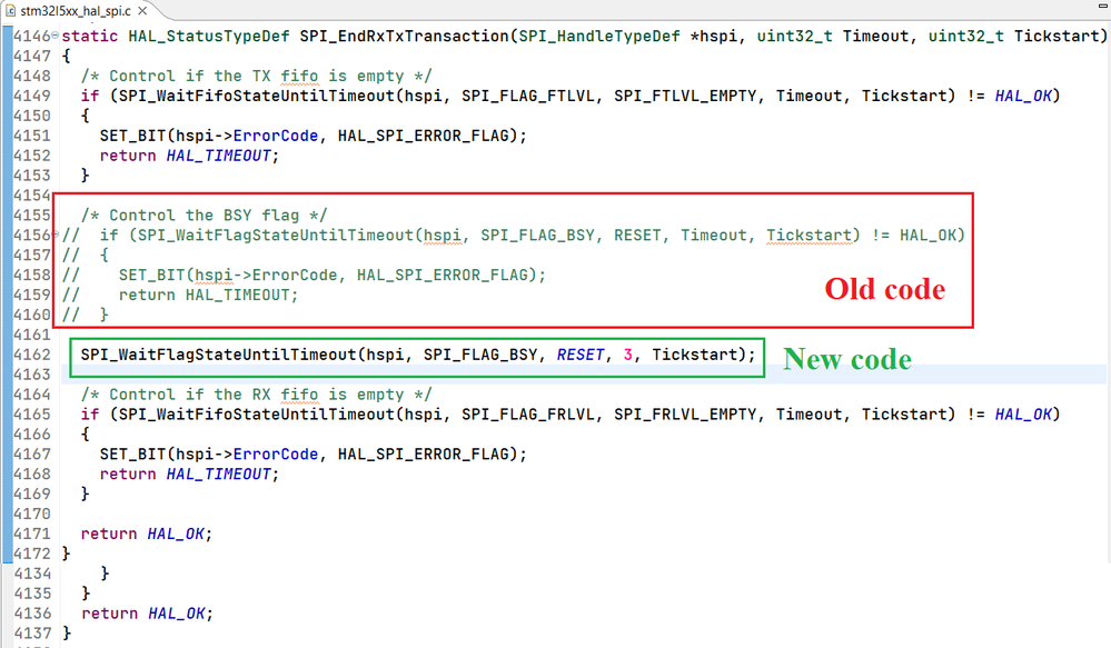

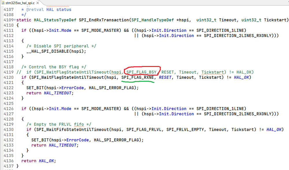

A fix for receiving:
For transmitting:
I don't like these changes. This is not a final decision. I will think about how to do it differently. The main thing is that it works as a proof-of-concept.
