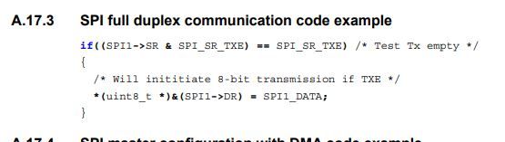

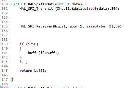

hi! I am using spi code off reference manual because i need make a function for write register and read the register. but with Hal not work well. i am make other function name:
but, this code not work, i copy of reference manual:

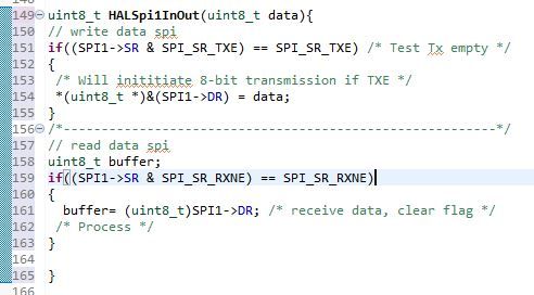

actually, i use the next code, but not work well:

I suggest to handle data overflow error flag. At case of SPI slave you can face even data underflow, too, if the software is not fast enough to handle TXE events.
