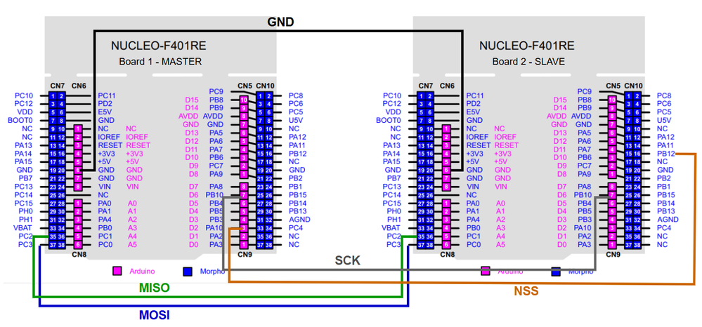

Below are the hardware connections (short wires from one NUCLEO board to another):
Connection diagram of the two NUCLEO-F401RE boards
Other information related to hardware:

@Brian_Azzopardi wrote:Below are the hardware connections (short wires from one NUCLEO board to another):
It's a lot easier to show connections as a diagram, rather than text.
Hand-drawn or ASCII-art is fine ...
I have drawn a diagram and included it in my original post... Thanks for suggesting!

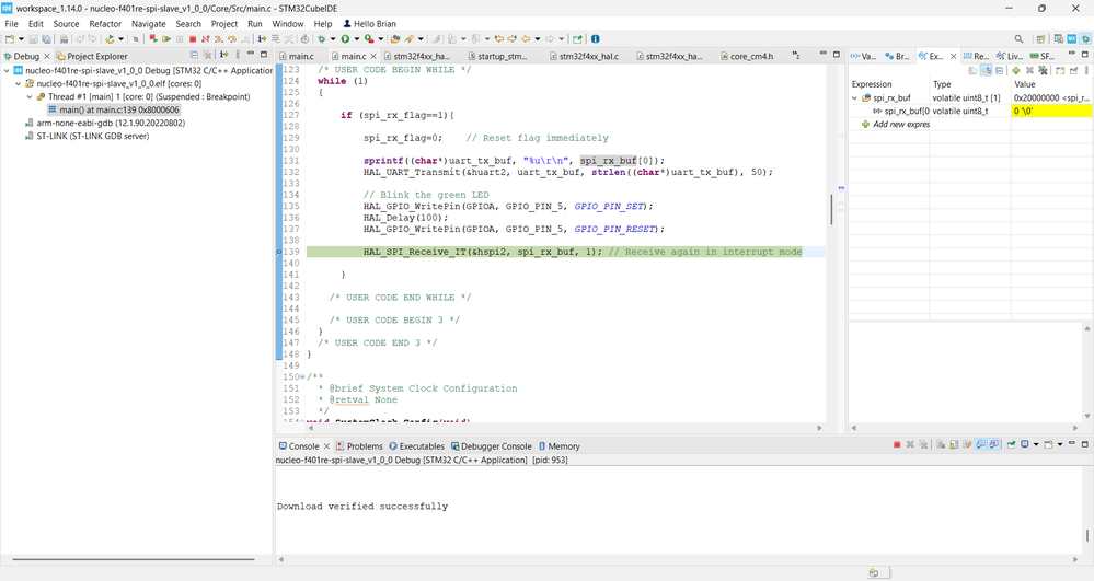

Hi @TDK ,
I have initialized spi_rx_buf with the value 0xAA and placed a breakpoint in while(1), within the if (spi_rx_flag==1) statement. Recall that spi_rx_flag is set to 1 in the SPI RX callback.
The value of spi_rx_buf is changing to 0x00, confirming that the SPI RX callback is being executed, and that 0x00 is being written to the buffer spi_rx_buf.
Breakpoint debugging and spi_rx_buf whose value is changing from 0xAA to 0x00
Could it be that the MOSI signal is not being sampled right, i.e. it is being sampled when the line is low, and thus resulting in a 0x00 value?
Brian

You're missing a ground connection between the two boards.
The grounds of the two boards were actually connected but left out from the connections description / diagram by mistake. Connections diagram updated.
