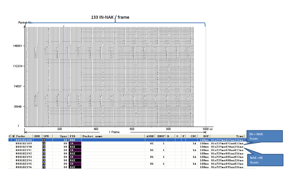

3. IN-NAK polling frequency
I want to increase the frequency of IN-NAK polling by the HOST in order to acquire data at high speed and with strict timing.
Unfortunately, IN-NAK polling is only done 20 times per frame.
Table 5-9 of Universal Serial Bus Specification Revision 2.0 states that, transfer can be issued 71 times per frame when data payload is 8 bytes.
Of course, I think the polling interval will change slightly depending on the response performance of the Target Device....
When the response performance of the target device is not taken into consideration, how many times can the USBHost sequencer issue the IN token per frame?

3. Regarding this, it was a rudimentary mistake to use a pile of IF statements to identify the interrupt factor in the ISR.....
I tried to make the number of cycles to clear NAK interrupts as short as possible in the ISR, and I was able to raise it to 133 IN-NAK polls per frame.
As related to Question 2, it was found that the response performance of the SW greatly affects the communication efficiency because the SW must handle the processing of the subdivided granularity.
The attached document is the acquired IN-NAK polling log.
The software load will be heavy, it may be possible to further improve the polling frequency.
