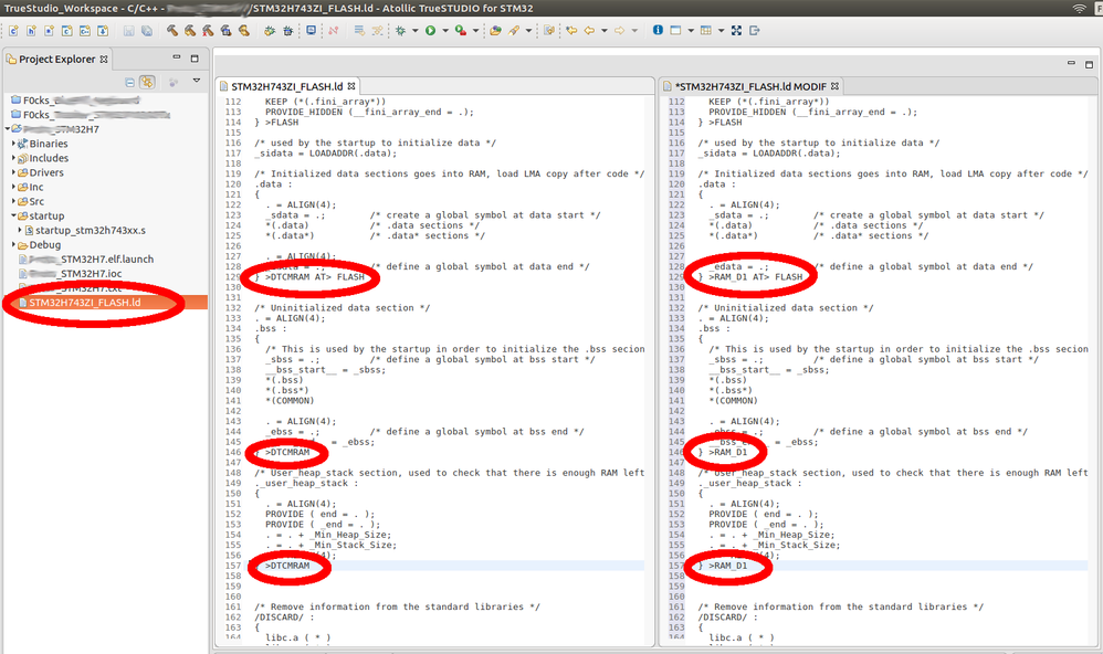

I've just found the difference between the HAL Nucelo example projects and the CubeMX generated projects.The problem for the DMA transfer error is that we use the false RAM!!
I have changed the settings in MDK-ARM from IRAM1 (default setting from CubeMX) to IRAM2 (same is in the example projects) and now the SPI DMA transfer runs without error.
enjolras.g
please check also in your project with TrueStudio and if it works, please share also the correct settings. 2018-03-14 1:29 PM
Schwaninger.Hannes
You have just saved my day! It is a little bit more tricky on TrueStudio ( maybe there is an easiest way but I have not found it): I had to open STM32H743ZI_FLASH.ld file. In this file I had to change every DTCMRAM to RAM_D1 in SECTIONS and ONLY in SECTIONS. LED is now blue!2018-03-15 2:09 AM
I'm glad that it works also by you and we both could now work normaly with the H7. ;)
