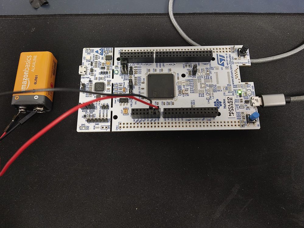

I'll add a picture of the board state, it is brand new.
Both LD6(PWR) and LD8 are turned on, and LD4 blinks slowly.

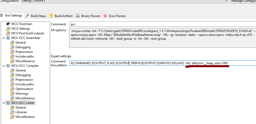

Hi, thank you for your response. I've tried changing the minimum heap size but to no avail, it still doesn't recognize the USB. I add a picture of how I've done it:

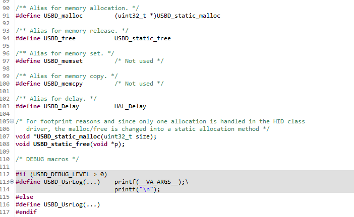

But in the article that you posted I don't know what I'm supposed to change to use static allocation, here in usbd.conf.h:
