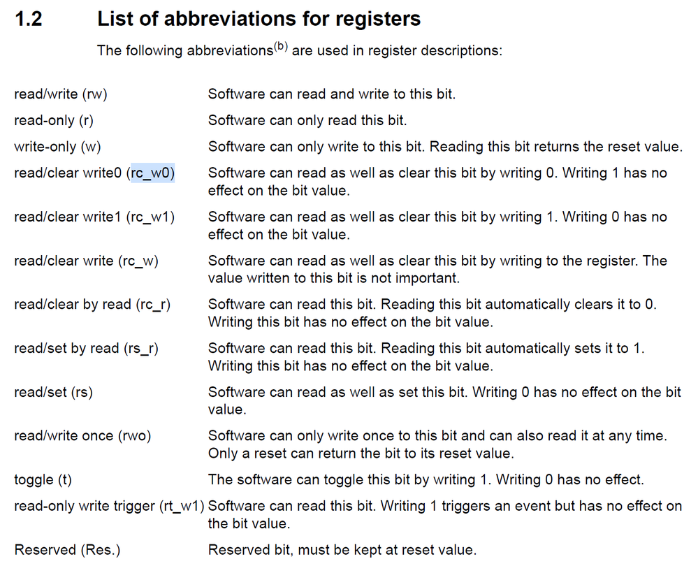

2022-03-11 7:10 AM
2022-03-11 7:12 AM
I don't clear any other flags than UIF. I don't affect them in any way. Whatever was 1, will stay 1. Whatever was 0, will stay 0. I don't see any problem. Can you provide a detailed example of something going wrong and how do you suggest I should do it instead.
Edit: I think I know what you mean after a little consideration. Indeed. I see it. Still, how do I fix it then? Your proposed solution looks plain wrong as it sets all 0 flags to 1
2022-03-11 7:15 AM
Checked the reference manual. The bits in status register are rc_w0. What exactly does it mean? (I take it it's OK to write smth there, but I want to know the definition of that thing to understand it)
2022-03-11 7:16 AM
"rc_w0, meaning software can write a 1 with no effect, or write a
0 to clear a particular status." Ok. I understand your answer! I got why you're right about everything. Thanks!
