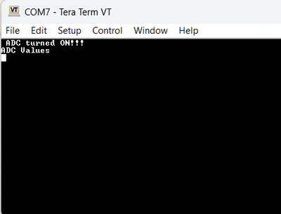

2025-03-05 7:19 AM
Thanks the feedback.. But still i face issue with USART, i cant print properly
2025-03-07 1:19 AM
Please use the '</>' icon at the top of editor, when posting code.
At the first glance, I don't see anything very wrong with your code, but that was the case with the first piece of code, too. Did you get it working as expected?
