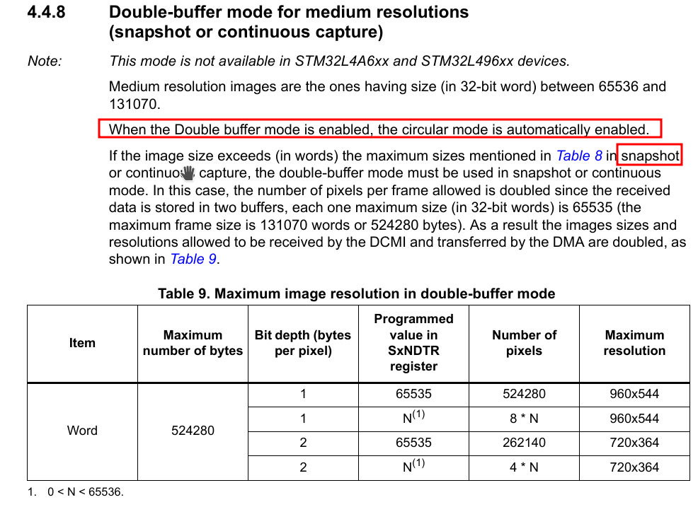

I am transferring 307200 bytes (640x480 gray) from DCMI to AXI SRAM using DMA1. When I do single transfer mode to do snapshot captures the DMA driver state never changes back from BUSY to READY so I can't start another.
I did 'fix' it with a hack in the HAL code for now but the problem seems in part from the fact that circular mode is forced by hardware when using double buffer mode. Double buffer mode is required when the transfer is larger than 64KWords and two transfers are required for the 307KB I need. Therefore then ending condition is never met because the driver checks that circular mode is off or on to know if the single transfer was complete and driver state should be changed back to READY.

Thanks for the response.
Its not a mem-to-mem transfer, its peripheral DCMI fifo to memory.
It just appears that the HAL driver does not correctly handle what is described in an app note, on how to transfer > 64Kwords sizes from DCMI snapshot. After this single snapshot the DMA driver state never goes back to READY. I can deal with it, but I thought I'd let people know about this issue.
