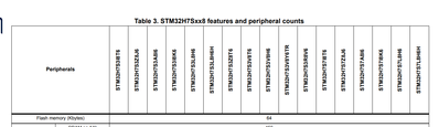

2025-03-14 1:15 AM
The System flash is from 0x1FF0 0000 to 0x1FF1 FFFF described on the page 151 of RM0477 Rev 8 manual.
2025-03-14 1:29 AM - edited 2025-03-14 1:42 AM
This is the bootloader. You don't have the access to program it:
The only access you have is the user Flash: 0x0800 0000 - 0x0800 FFFF
