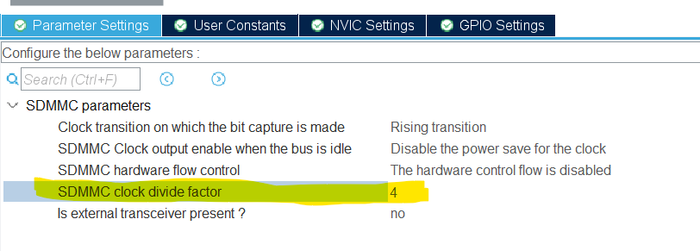

Update on this issue which might help others in future.
I found this project on Git-Hub: SquadQuiz/NUCLEO-H755ZI-uSD-FatFS-DMA: ST MCU NUCLEO-H755ZI-Q Development board, Implementation of [SDMMC uSD + FatFs + DMA] with STM32CubeMX Code Generation . It provides a very complete step-by-step guide which should be useful for anyone using SDIO uSD cards on H755 Nucleo.

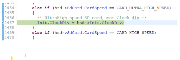

The key issue cause problems for me was confusion about these #defines in stm32h7xx_hal_sd.c:
#define SD_INIT_FREQ 400000U /* Initialization phase : 400 kHz max */
#define SD_NORMAL_SPEED_FREQ 25000000U /* Normal speed phase : 25 MHz max */
#define SD_HIGH_SPEED_FREQ 50000000U /* High speed phase : 50 MHz max */
I thought they'd do what the comments say, but that's not exactly right. I had left the GUI parameter "SDMMC clock divide factor" (see below) at its default value of 1, rather than 4 which I'm now using.
If you follow the logic in function HAL_SD_ConfigWideBusOperation() in stm32h7xx_hal_sd.c, it turns out that, if your uSD card is ultra-high speed, and if the value for "SDMMC clock divide factor" is less than that corresponding to SD_NORMAL_SPEED_FREQ, then the highlighted line of code is going to be hit, where hsd->Init.ClockDiv = <your GUI value, default = 1>
Putting this more plainly: The default value of "SDMMC clock divide factor" = 1 corresponds to a clock frequency that is very much faster than SD_NORMAL_SPEED_FREQ, and for an ultra-high-speed uSD that faster clock will be used, with SD_NORMAL_SPEED_FREQ and SD_HIGH_SPEED_FREQ being ignored.
Key take away => Don't leave "SDMMC clock divide factor" at its default value, and beware those #defines which are - in my opinion - not very well described in the code.
