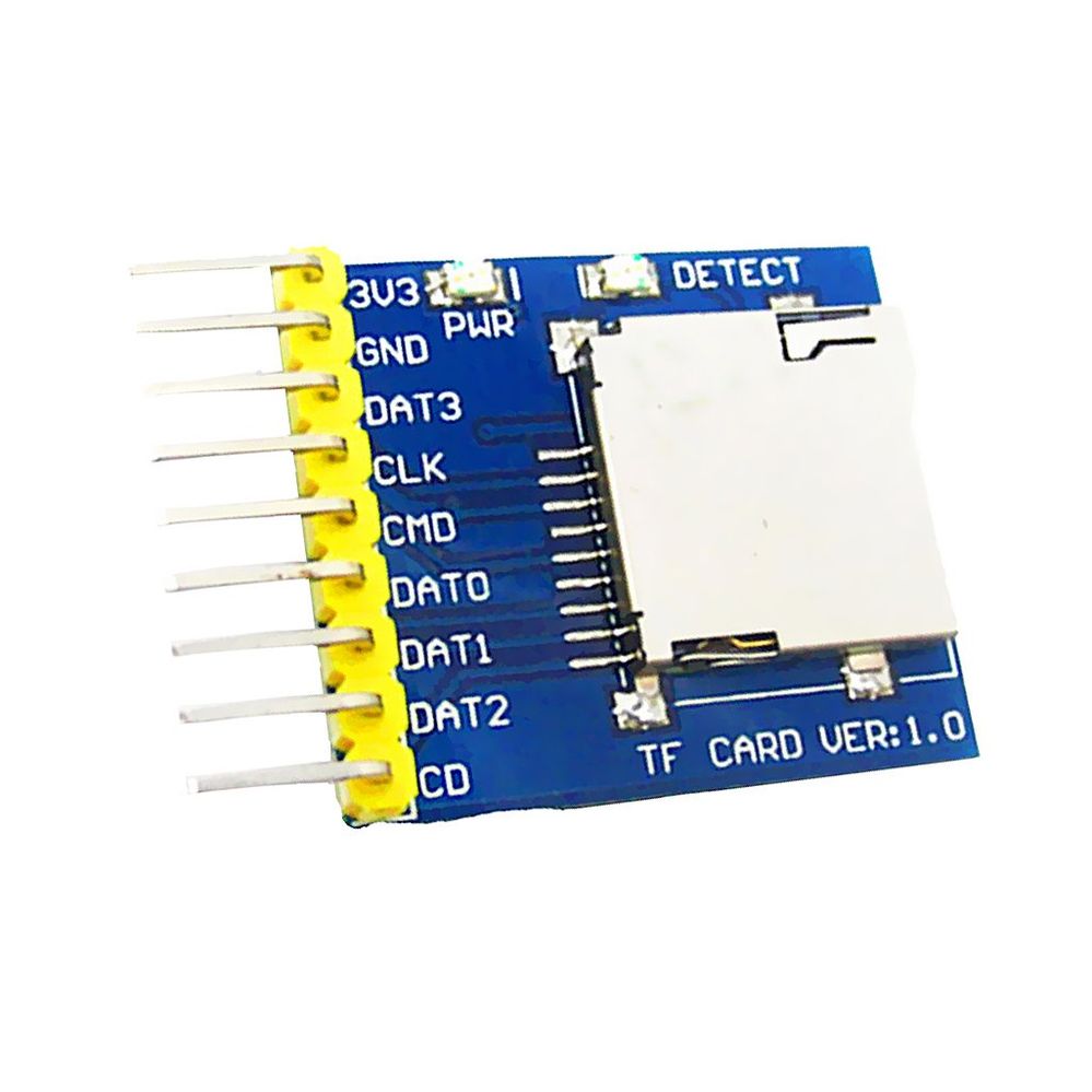

i am using NUCLEO-F413ZH board. In my SDIO card reader pullup resister available.
i am using 32GB micro SDHC card class 1.This is my SD card reader
