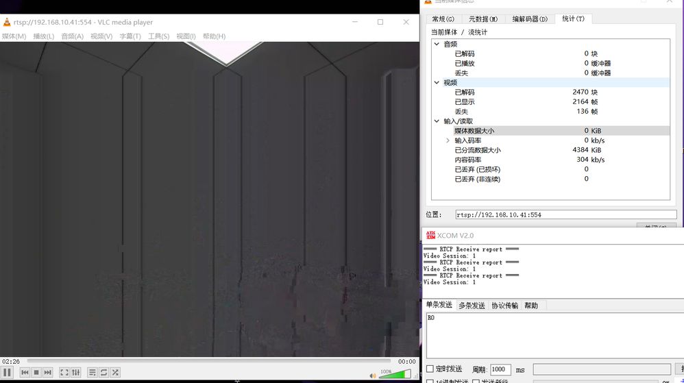

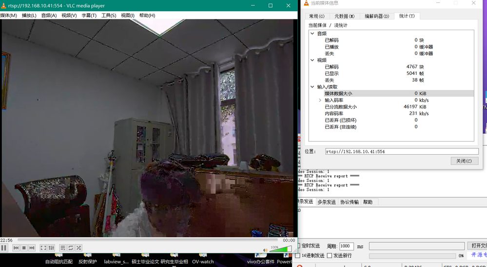

Symptoms:
VLC can successfully open the RTSP stream and display video.
The video is very blurry, especially during motion, where details are hard to distinguish.
The frame rate is very low (VLC statistics show high frame loss and decoding frame rate below 10 fps).

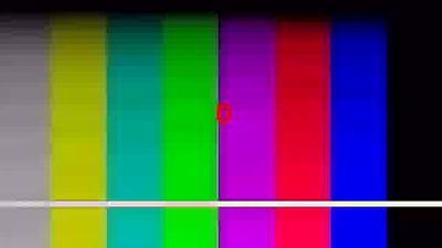

Hello qiqi
These are macroblocks.
It looks like a network issue rather than an encoding issue: packets are lost, and the decoder cannot reconstruct the whole image.
The lower frame rate probably also results from a poor network connection.

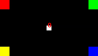

1. Try testing with a known test pattern versus the camera feed, e.g.
Color blocks in the corners with a frame counter in the center, or another known test pattern.

I agree with @DanielS , in that you are most likely dropping packets.
Testing 1 you can check with a simple fixed pattern. If that doesn't work then there are fundamental problems.
If 1 does work, then perhaps it is a bandwidth problem.
