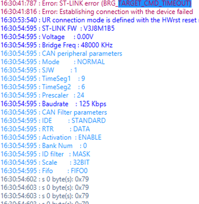

We have developed a CAN based custom Bootloader and we would like to flash the application software using STM32CubeProgrammer and STLINK-V3SET. We have provided 3.3V Supply, ground to STLINK_V3SET module and connected CAN_Tx and CAN_Rx through a CAN transceiver board. Jumper J7 is closed as well. STLINK-V3SET module is detected by the STM32CubeProgrammer when powered and connected through microUSB cable. Selected the STLINK-V3SET module and enabled the CAN interface option with default values. We pressed the connect button, we are getting the following timeout error.

Finally we have concluded that our test set-up is all good including the Transceiver and all hardware connections except STLINK-V3SET, There is something not good in STLINK-V3SET (jumper connections or wiring or firmware in STLINK-V3SET).
If you are able to establish the connection between STM32CubeProgrammer and STLINK-V3SET, kindly share the log file to see the communication between STLINK-V3SET and Target board.

Well looks to be communicating. Not sure how well your loader mirrors the behaviours of ST's. If one works whilst the other doesn't you'll need to debug in a Compare and Contrast sense.
This isn't my use case, I'd suggest you work with one of the paid ST support staff or FAE on your account. Or open an Online Support Request
