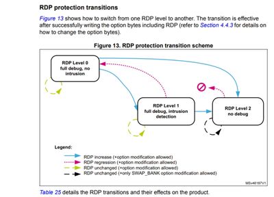

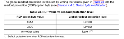

Hello @Freshna
Setting the RDP (Read protection) to 0xCC means you have activated the RDP Level 2:
Then is going to be impossible to reduce the protection level.
That's why you need a new board now since this board is locked.
best regards.

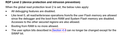

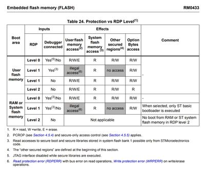

The ST Boot Loader is in OTP/ROM, you can't erase it or replace it.
You could try adding a jumper to connect BOOT0/VDD this would perhaps allow for connectivity in the case the MCU is getting into the wrong mode via user code. It will not fix Option Byte issues, especially if you disabled SWD/JTAG connectivity, as RDP 2 is non-reversible.
