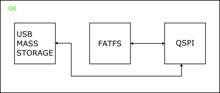

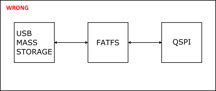

2018-03-22 10:47 PM
Thank you for answer,
Ok now I think I get the idea... Please confirm either this is right or wrong. I thought the design for this would look like this:
Where as it has to work like this:
The USB mass storage cannot use the FatFs file system, since it already has its own file system. The FatFs mapping has to be 100% covered with the maping done by the windows or linux computer connected through USB. Is that correct?

Yes, and only one of these should have control otherwise you will get coherency issues and damage, as Windows will cache content and write with no regard to what FatFs might be doing.
