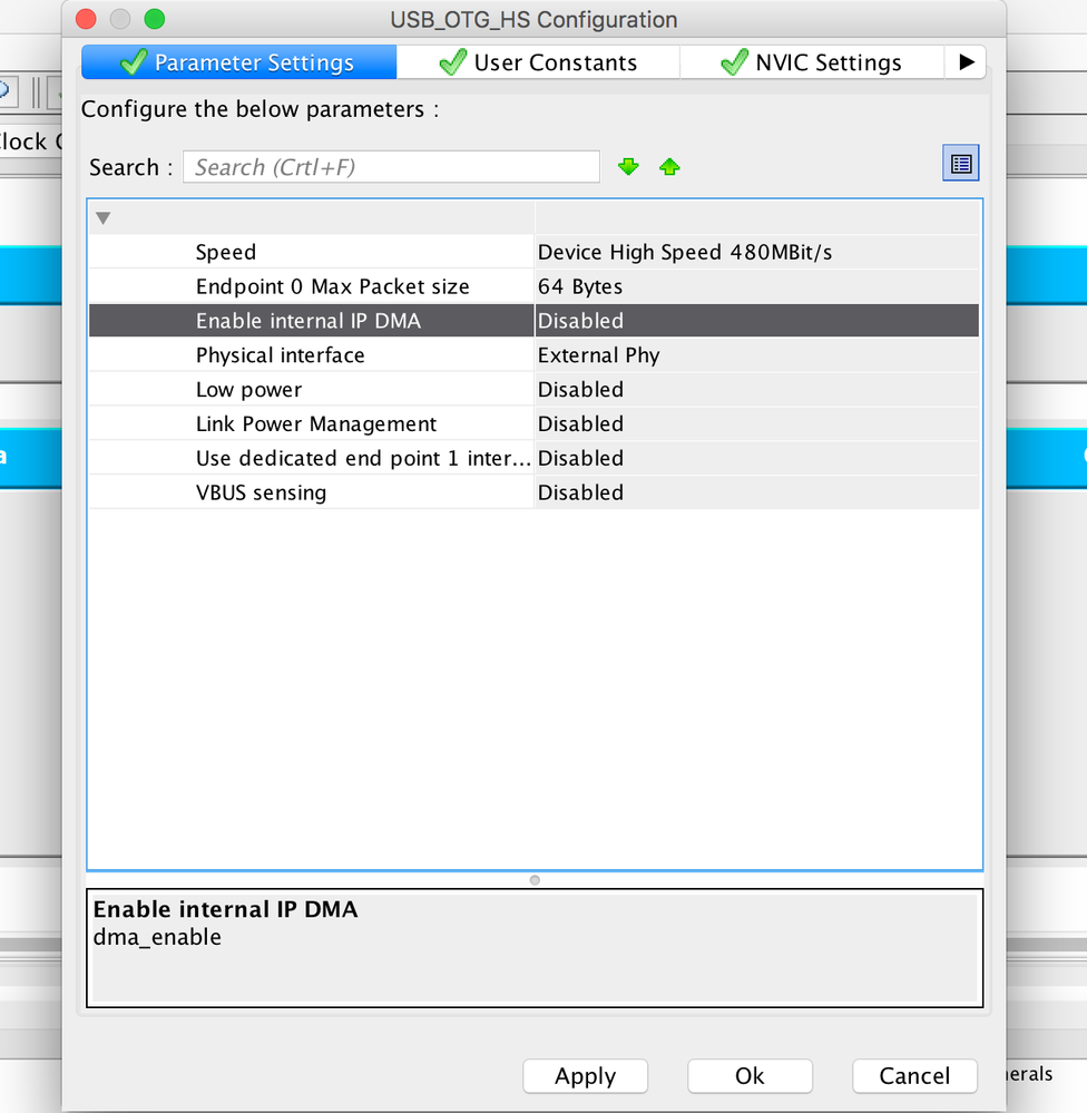

Thank you, this was helpful, but I still have a question...
If I understand you, you are saying that DMA is enabled by default and it is the only way how USB HS works.
But in the usbd_conf.c file there is a definition where it could be enabled/disabled:
USBD_StatusTypeDef USBD_LL_Init (USBD_HandleTypeDef *pdev)
{ /* Init USB_IP */ if (pdev->id == DEVICE_HS) { /* Link The driver to the stack */ hpcd_USB_OTG_HS.pData = pdev; pdev->pData = &hpcd_USB_OTG_HS;hpcd_USB_OTG_HS.Instance = USB_OTG_HS;
hpcd_USB_OTG_HS.Init.dev_endpoints = 9; hpcd_USB_OTG_HS.Init.speed = PCD_SPEED_HIGH; hpcd_USB_OTG_HS.Init.dma_enable = DISABLE; hpcd_USB_OTG_HS.Init.ep0_mps = DEP0CTL_MPS_64; hpcd_USB_OTG_HS.Init.phy_itface = USB_OTG_ULPI_PHY; hpcd_USB_OTG_HS.Init.Sof_enable = DISABLE; hpcd_USB_OTG_HS.Init.low_power_enable = DISABLE; hpcd_USB_OTG_HS.Init.lpm_enable = DISABLE; hpcd_USB_OTG_HS.Init.vbus_sensing_enable = DISABLE; hpcd_USB_OTG_HS.Init.use_dedicated_ep1 = DISABLE; hpcd_USB_OTG_HS.Init.use_external_vbus = DISABLE; if (HAL_PCD_Init(&hpcd_USB_OTG_HS) != HAL_OK) { Error_Handler(); }HAL_PCDEx_SetRxFiFo(&hpcd_USB_OTG_HS, 0x200);
HAL_PCDEx_SetTxFiFo(&hpcd_USB_OTG_HS, 0, 0x80); HAL_PCDEx_SetTxFiFo(&hpcd_USB_OTG_HS, 1, 0x174); } return USBD_OK;}PS: Don't know how to paste it as a code.

I am not opposing you... I came to that LL definition, because I first saw in CubeMX that there is an option under Configuration tab, to enable or disable DMA. See the attached photo... I will definitely try this with a timer...
