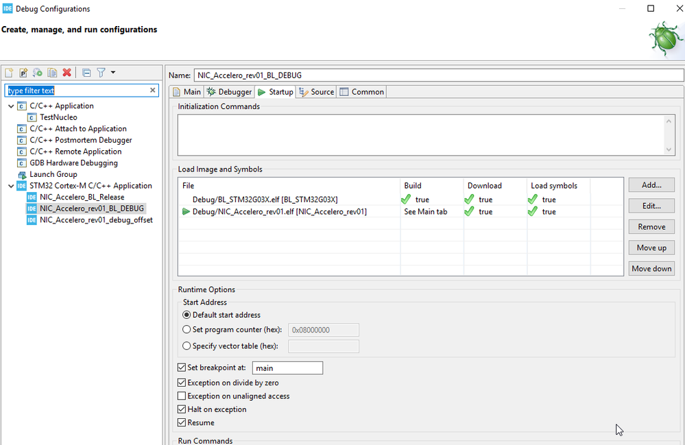

when i run the debugger with above settings , the debugger starts at in main(void) from the end user application? I expect the debugger would start in main of the bootloader.
But when i press the reset chip button, then the debugger jumps to the first line of the bootloader (as expected).
At this point the debugger start running the bootload program, and jumps to the end user main loop as designed, so the bootloader does what i need to do.
