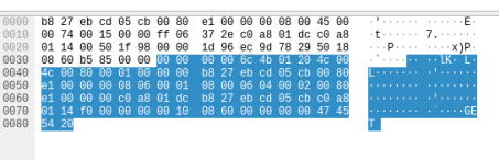

On my Raspberry Pi, I can see with Wireshark, that the TCP connection is working and the package is sent to the right IP adress and Port. But the data of the package looks very strange and the web server is doing nothing.
So I think the http request is not written correctly to the TCP package.
