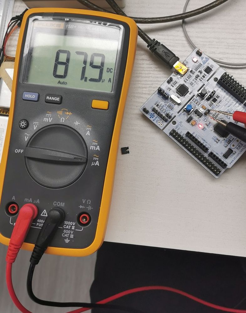

7 watting for the "LD2" not blinked , the current measured in "jp6" is about 87uA.

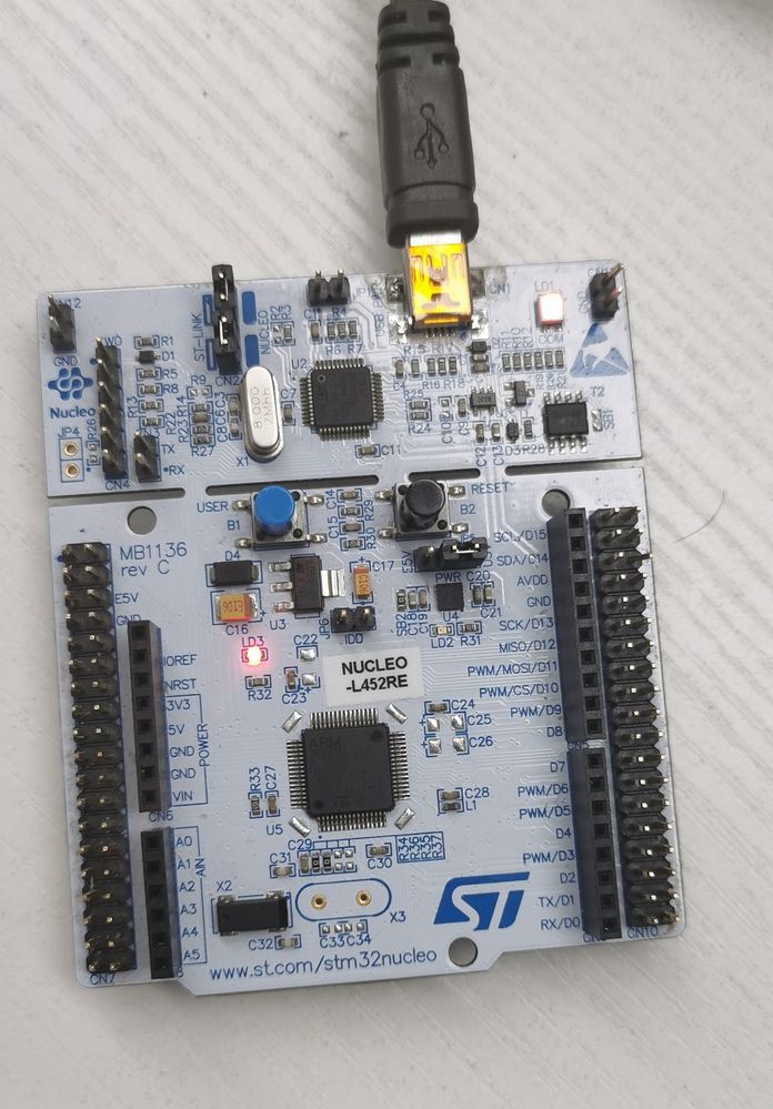

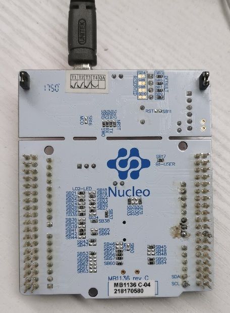

this is the photograph of my board setting,nucleo-L452RE
an product of mine with stm32L451, it is also about 80uA when we set it in stop1 state .
