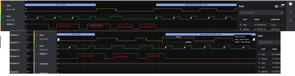

I2C bus @400kb, read *one* byte in memory mode from slave 0x6B.
Bottom row is a GPIO that I bring high when entering HAL_I2C_EV_IRQHandler() and low when I exit.
Added event log code to HAL_I2C_EV_IRQHandler(): #if DEBUG_I2C_EVENTS
if(evtCnt < (MAXBUF))lastEvtBuf[evtCnt++] = (sr1itflags | (sr2itflags<<16)) & 0x00FFFFFF;
if(evtCnt >= MAXBUF)evtCnt = 0;
#endif

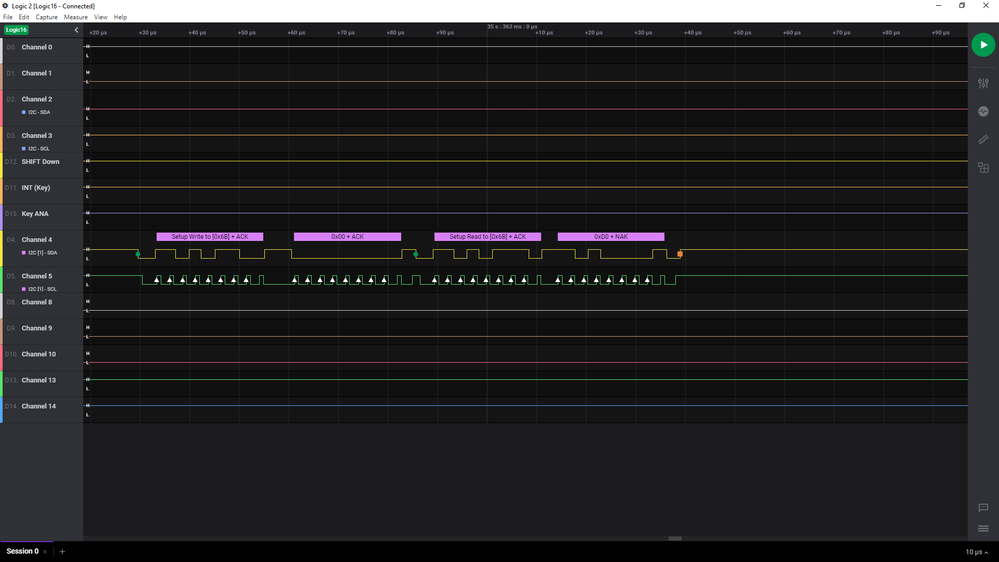

A normal sequence:
And error sequence:
I'm not really sure but it seems that, when the double start occurs, there is a slight delay for the ISR handling of Master mode byte transmitted (0x00070084) event, this generates two starts and consequently the event Master mode receiver mode selected (0x00030002) is not triggered.
Please let me know if you need anything more. I'm not sure its a bug, but with my change it seems to work so-far.

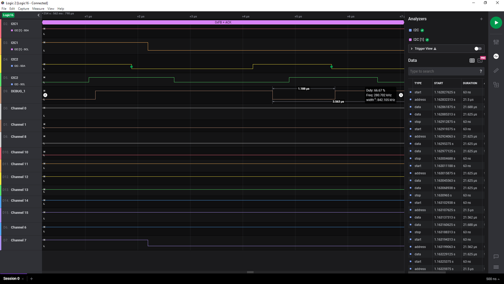

Sorry, there was a problem with the last image, here it is:0693W000002lD9mQAE.png
TKube.1
Associate II

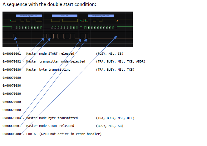

And here is a zoomed in view to see the phases if ISR handler and the double start:
It looks like the second start is actually triggered before START released event (0x0030001).

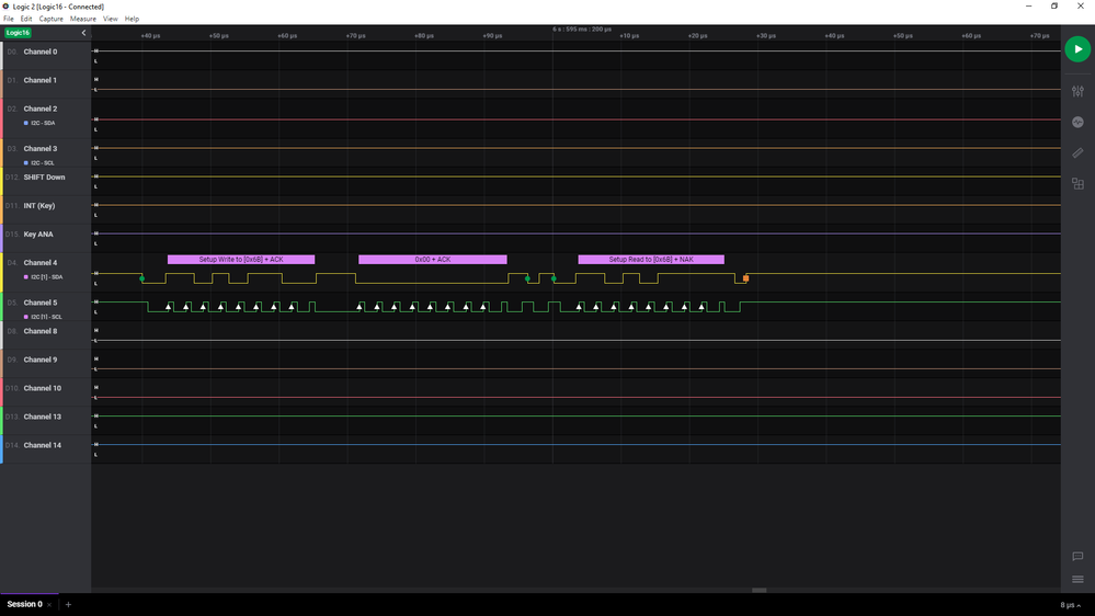

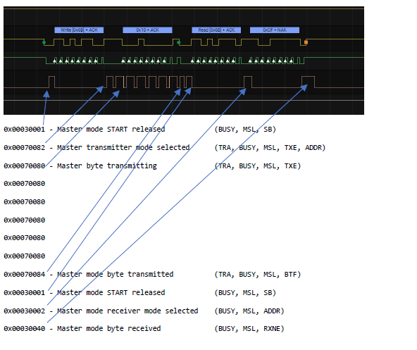

I tried to make a better image with both a normal sequence and one with the double start, I think I got the states correct but its a bit perplexing, but it might be of interest.
I'm sorry I think I got the states of the normal sequence one step incorrect (its a bit hard to match manually).
I think this might be more correct:
