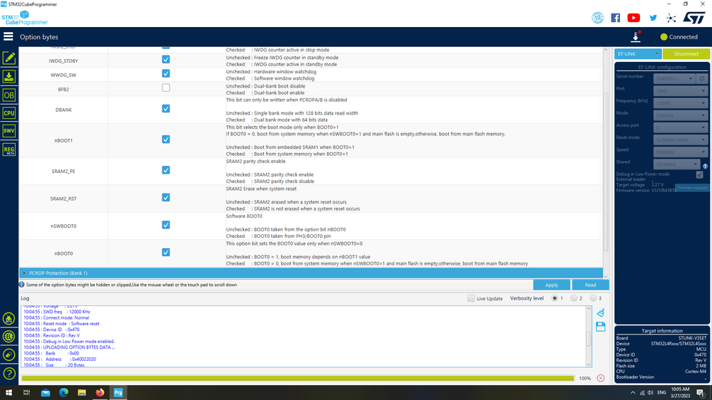

I did pulled up pin PH3-BOOT high (3.3V). I tried simple code but it looks like it is sitting there and doing nothing. I get this error message. Most chips would have just BOOT pin one function not PH3-BOOT.
Multiple errors reported.
1) Failed to execute MI command:
-var-create - * b
Error message from debugger back end:
-var-create: unable to create variable object
2) Unable to create variable object
3) Failed to execute MI command:
-data-evaluate-expression b
No symbol "b" in current context.
4) Failed to execute MI command:
-var-create - * b
I do not see if I need to change anything. I wonder if it has to do anything how the chip boot up0693W00000aJmPBQA0.png

Well, as the screenshot says: with BOOT0=1 you boot from the system memory. This puts you in the bootloader, which waits for commands from outside. Since none comes, it waits.
If you want to start your user program normally, you should set BOOT0 to logical zero, in the simplest case directly to GND, if you need the boot loader later, set it to GND via a pull-down.

BOOT0 has always had to be set to logical 0, but there are derivatives with a BOOT1 that has to be set to logical 1. However, this cannot really be generalised, since in the meantime it can also be determined via option bits whether BOOT0 is queried for the decision or not.
You didn't mention it, but according to the screenshot, your specific case is STM32L4R/S, where in fact PH3-BOOT0 is a dual function pin to provide as many pin functions as possible. Its datasheet says in section 3.8 Boot modes:
The BOOT0 value may come from the PH3-BOOT0 pin or from an option bit depending on the value of a user option bit to free the GPIO pad if needed.
And RM0432, section 8.3.15 Using PH3 as GPIO mentions:
PH3 may be used as boot pin (BOOT0) or as a GPIO. Depending on the nSWBOOT0 bit in the user option byte, it switches from the input mode to the analog input mode:
  • After the option byte loading phase if nSWBOOT0 = 1.
  • After reset if nSWBOOT0 = 0.
So the user has the choice of what to do with PH3-BOOT0:
  • If he fixes it to GND, it obviously serves only as a BOOT0 pin and you cannot and should not use it as an output.
  • If, on the other hand, you connect it to GND with a pull-down of e.g. 10...100kohms, you can also use it as GPIO PH3, whereby only the pull-down must not interfere with your circuit.
Clear now?

Using STM32 cube programmer I have flashed boot option using option bits and later I have flashed application and It's working fine. Is there is any other way to make application start from system memory?
