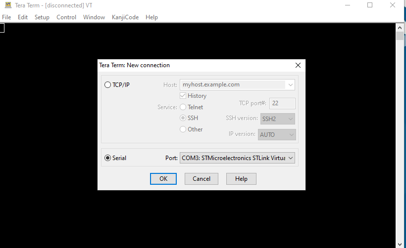

Issue : When I access COM3 port using Tera Term / putty it shows me blank screen,
Why it don't print Helllo World on putty or Teram Term console ???
But On this board I can run LED blinking programs successfully.

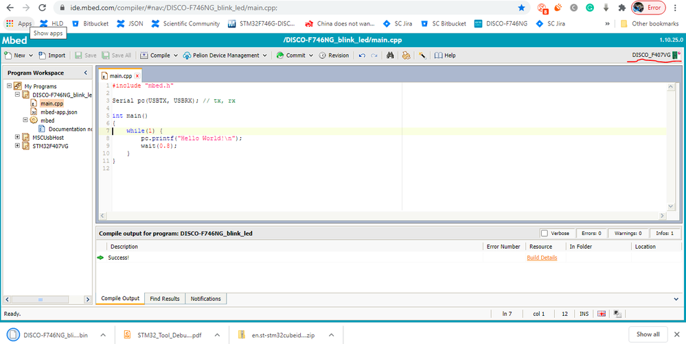

Code :
#include "mbed.h"
Serial pc(USBTX, USBRX); // tx, rx
int main()
while(1) {
pc.printf("Hello World!\n");
wait(0.8);
Kindly refer below screen snaps of Virtual Com Port, Tera term and Code for more detail.
2020-07-06 6:02 AM
Check that your port settings match on both sides. Probe the lines to make sure a signal is actually sent.
2020-07-06 9:37 PM
@TDK : Kindly elaborate what exactly I should do to port settings match on both sides ? I spend lot of hours in fixing this issue.But not able to find any fix for it.
2020-07-07 7:11 PM
You'll need to dig into the documentation of whatever software you're using. It's not clear if Serial is using a UART port to talk to the ST-Link or if you're using the USB itself to act as a VCP. I suspect it is the former, in which case the baud rate, data bits, parity and stop bit settings need to match on TeraTerm and within your STM32 UART initialization.
2020-07-09 2:44 AM
I tried with baud rate 9600 and 115200, But it don't work for me.
Any more suggestion ?
