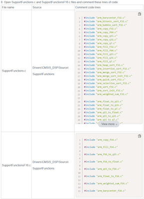

I think you have an issue with multiple definitions, in this case you need to go through every folder in Drivers/CMSIS_DSP/Source and comment out every #include "file.c" in "folder name.c" and "folder nameF16.c"file.
An example to support SupportFunctions is shared in this FAQ step 8.
Please look at this example and apply this solution to all folders in source.

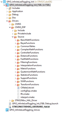

@KDJEM.1 Thank you for the recommendation of the -flax-vector-conversion flag. It has enabled me to get further into the project build process, but I am still having errors in the build of the CMSIS functions. It appears that the .c files are being built twice, and during the second build, it fails due to "multiple definitions." I have not had this issue on my previous CMSIS projects using m0+, m4, or m33. The path for both definitions appear to be identical.
Can you please recommendation a solution? Thank you.

Thank you. Each of the folders had two .c files that #included all the other .c files. After deleting these files from the folder, I was able to build the CMSIS library.
