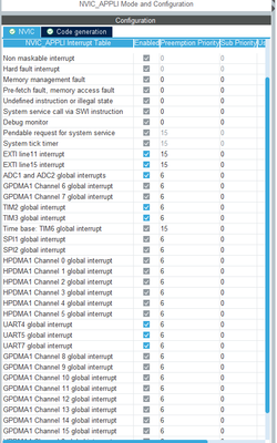

I also already checked the NVIC, but it seems pretty fine to me. Did i otherwise miss something what i configured wrong inside my IOC file?

It seems to be that SysTick_Handler() is not beeing called by the FreeRTOS.Is that a problem with the NVIC?
EDIT: This is the solution, to set all the interrupts which are not 0 or 15 to something above 5 in my case, it may vary depending on your FreeRTOS configuration.
